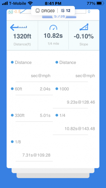

@16GoManGoHC2 is draggy good for recording race day conditions? Is it accurate per the track?
Yes, VERY, especially the newest version. I posted a screenshots of track time, slips and draggy screenshots and most times 60’, 330’, 1/8, 1000’, 1/4 markers were within .01 seconds draggy verses track timer. I’ll see if I can find any of those photos.

3,451
8,173

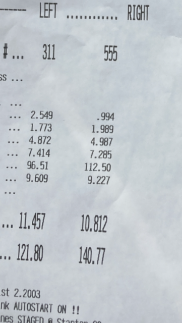

Here’s an example I found. I’ve did comparisons many times, some have been much closer then these but these popped up in recents. Draggy get the ET MPH high as it records instant MPH at 1/4 end where the track looks at trap lights point A to B lights over maybe the last 50-100ft, I forget exactly what the distance is. This was running the 20” 305 Conti’s at the track. M6 remember, not the best 60’ times.
