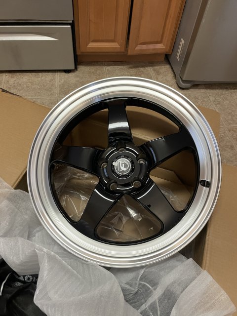

Is anyone running these on their front wheels? https://www.mandhtires.com/M-H-Drag-Tires/M-H-Front-Runner/185-50R18-FRONT I just stold my 18" RaceStars locally with Sportsman S/R. The S/R is a heavy ass tire and I'm looking to replace them with something lighter. I saw these on the site in research and was wondering if anyone has an honest opinion of them? For reference they are going on my new ForgeStar D5 18x5 wheels. Pics of said wheels...

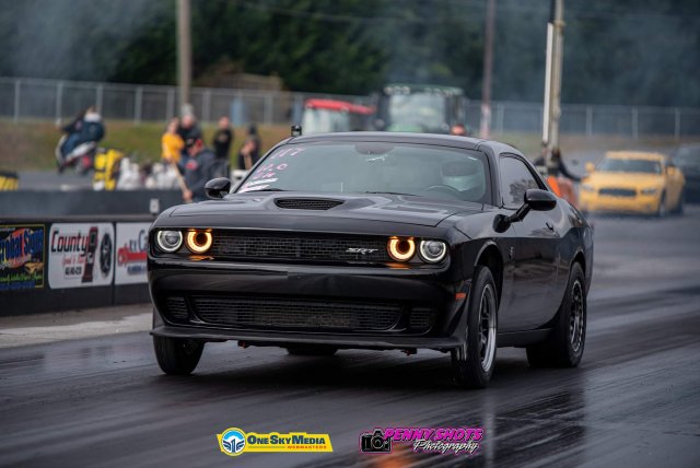

They are just fine. If youre worried about load rating then get the S/R, I’m not, heres why. M&H doesnt post a load rating on their website for their DOT radial. Hoosier doesnt post a load rating on their website for their DOT radial. 🤷🏻‍♂️ I drove to Cecil and back which is 63 miles each way, made multple passes and even got this beautiful picture.
Had zero issues at the track. Proper inflation plus driving like a normal human and you will have no problems. Would I daily them? No.
