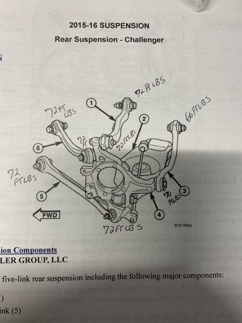

Agree. For some really strange reason, they recommend the final torque with the wheels on the ground. See if that does it.
Did you change any of the control arms too? Remember some links (don’t know if yours will) make the sway bar bang the top of the AAD top arm.
3,784
9,382
no change of the control arms, still factory. Just printed out all the torque specs and found the part in the FSM where it all has to be torqued under load

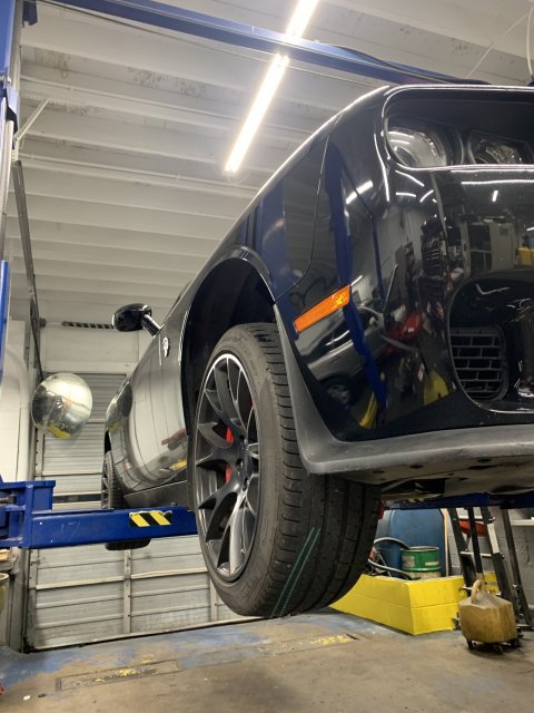

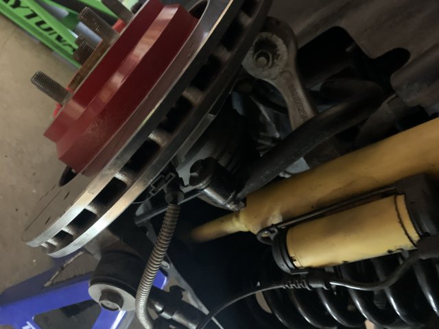

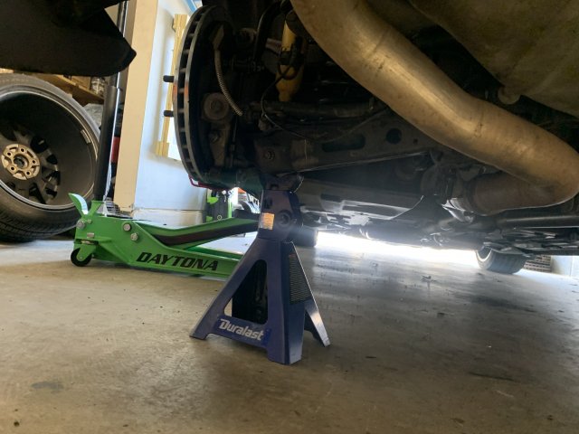

Played whack a torque for an hour...
955550B1-830B-4CF6-AE81-B0A729842EC3.jpeg 11EC063F-8F6C-4EF3-8C3E-64D3587617D7.jpeg 69CFBC04-829A-4FE0-B5C6-EE6894CC51C1.jpeg
Didnt fix it. Mike literally ran behind the car as I went left to right and we isolated it to the rear left. With that being said we re torqued everything and did the same procedure. Isolated sound to rear left shock. We are in surgery right now.
