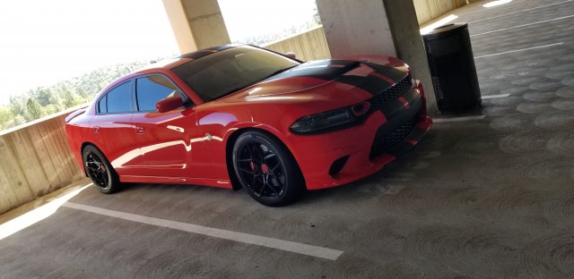

Hey guys, I recently wrapped the rears in 305/35/20 Nitto 555r's and still getting some slippage. The best 0-60 that I've had so far, out of two runs, is 4 seconds flat. Granted, I was in the mountains of Mexico when I did this so maybe elevation played a factor? I thought these tires can get you to the mid/low 3 second 0-60?
Anyone have any advice on how to launch this cat? I haven't done a burnout yet if that matters, just feathered then mash the pedal down.
Psi currently is 32/33 depending on temperature.
