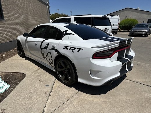

Here's what I'm talking about... Would love just a plain white Charger... but the stripes, and over the top cat heads on the side. Yee.

Little too much (for me as well). Stripes look good though. What @MikeD1 said about the environment it has been in. Looks good.
I would do hair dryer along the stripes as you peel off. No experience though.

I could live with the stripes, but that cat head would have to go. Being white and the cat never getting direct overhead sun makes getting complete removal likely, imo.

I have the stripes on mine, would not have ordered it that way but they have grown on me. Not a fan of the giant cat heads, that would have to go. On the fence with the SRT, but I'd probably peel that as well. Since it's white & looks well kept I'd say you have a very good chance there will be no 'shadow' left behind unless they had ceramic applied after putting the head on.
I'd plan on a pro paint prep/correction after just to make sure it blends.

Those decals 99% of the time will leave shadows and many times an imprint in the paint unless they were just put on.
