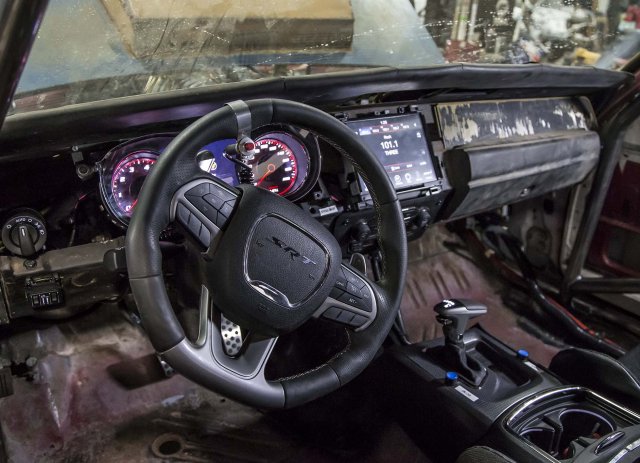

Look at the Roadkill 68 Charger - swapping in a Hellcat...
I looked at everything they had to swap to get it to work...
