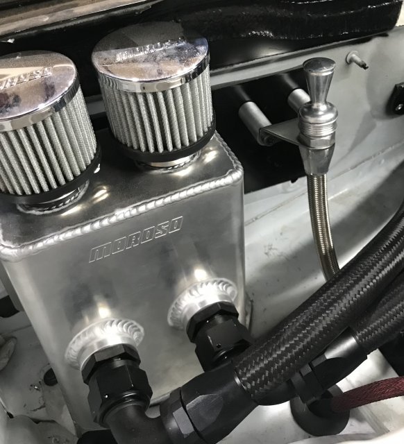

Many if not most high power cars are going to what in other circles is called the burn down tank. It vents to the outside behind the car. Usually through the deck lid. The reason is these motors have the potential to suffer a catastrophic failure that pressurizes the crankcase and they can expel gallons of oil. You don’t want that happing in front of the rear tires. I’m looking at building this into the new structure in the rear of the car. I saw that Colby just did his. IMG_6449.jpeg

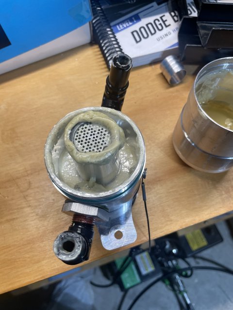

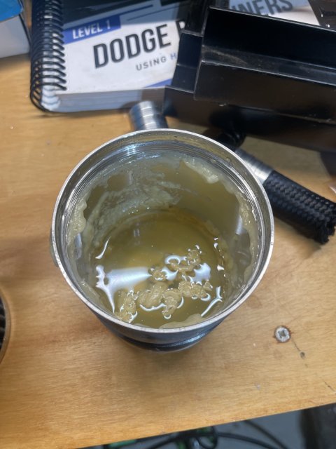

I don't agree with this at all. I'm a mid nine-ish car on a bad day. This is what is caught.
A proper catch can on a Hellcat goes a long long long way especially when driven.

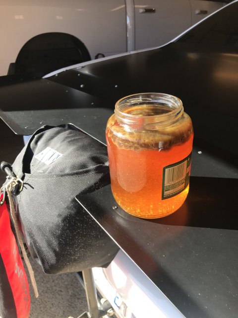

Mine catches "some", but clearly not "all" based on my intake.

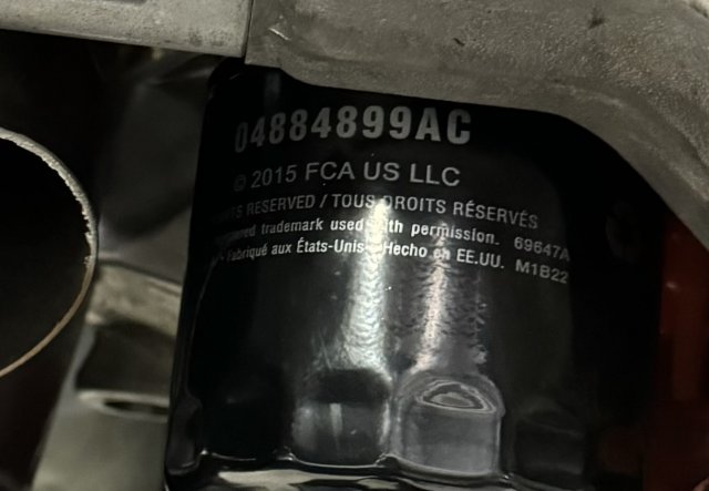

There is a huge difference between the 899 and 041 filters. Just something to think about.
3,791
9,388
Thread Starter #16

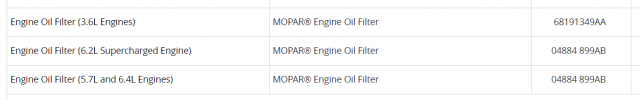

I don't see anything different in the filters other than price and pressure flow. SRT engineers designed this filter for the Viper not the Hellcat. The Hellcat oil pump is vastly different than a viper one. Just so someone can draw their own conclusions:
Factory service manual:
Have your car at a dealership, you're getting an 899 filter.
3,431
11,005
14,355
76,826
After buying a couple of 041's with center tube louvers that were barely open or even closed, I went back to the 899 which has holes. Also, micron ratings alone are meaningless. They have to be stated along with the efficiency rating to be meaningful.
3,326
5,815
WHEN I WAS RUNNING MY CAT I CHANGED OIL EVERY WEEKEND I RACED AND I ALWAYS RAN THE SRT FILTERS AND WOULD CUT THEM OPEN /WITH THE STOCK ENGINE THERE WAS NEVER ANY METAL AT ALL ,YEA I SPENT ALOT OF MONEY ON OIL CHANGES BUT BECAUSE OF THE STRONG E85 SMELL IN THE OIL I DID IT TO PREVENT ANY ISSUES
14,355
76,826
One more consideration. The 041 has a dome end bypass valve and the 899 has a base end bypass. When a dome end filter goes into bypass, the oil washes over the dirty side of the filter media.
