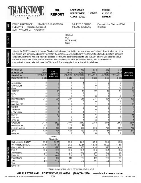

Just for comparison...
(IGNORE the comment about "dropping the pan", I don't do that, they misinterpreted my comments about the oil change process I do.

@BULL so from yours it would appear the break in copper/iron are a thing since yours has so few miles on it and so few on the oil itself. I mainly did this check to make sure my once a year OCI was G2G on E85 and it is no problem. I've had a couple people comment on the video that their older F150 or Ram FFV had comments on shorter OCI when running E85 similar to the towing OCI. I checked a 2016 Caravan, 2019 F150, and 2018 Silverado in my research and none mentioned anything other than Ford calling out to run a tank of gasoline every oil change. Not sure what that would even do over a 5-7K mile OCI though. I'm personally gonna run 1/2 tank of 93 every month just because.

The thing that has driven my crazy change intervals has been that I change oil based on the following starting from new:
At 500 and then 1500 total miles
Then after any "racing" event, or 6 months, or 3000 miles, not that I ever get that far in this vehicle inside of 6 months.
There's a handful of changes that have fallen off the end of the report too.
This last interval, I let it go out to a year because I forced myself to. So few miles, no "events", and so many changes behind it.
Last year or two has been rough, and sad for actually driving the car.
