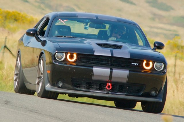

I would go with a 40 series tire all of the way around if possible otherwise it will look off. Below is my car not lowered on a 285/35R20 in the front/back. I know it is not a Charger but you get the idea. If you must stay in a 35 series tire I would go 295 up front, it will be a little over 1/8" taller than the 285/35.

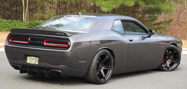

285 front, 305 rear for comparison.

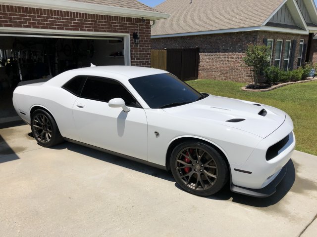

275/40’s up front and 305/35’s in rear. Not much gap.. I’d like to lower with mopar springs but would probably end up scraping my driveway🙄

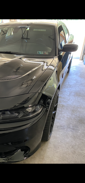

I have 285/35 Michelin ps4s front and 295/35 Michelin ps4s rear on 10.5 repos on my Charger all the way around. You don’t want any bigger than 285 up front if your talking about the charger non Widebody.. 285 already stick out a bit from the wheel fenders but not so much that it looks off.. 80B77EAF-5AC4-4084-BBD3-3CC34F3C2055.png 2AFDC05E-2301-4B04-96AB-5A04D0302C98.png

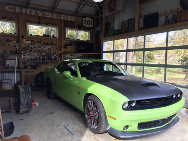

I run 295/35 all around. The Michelin’s as a brand are wide compared to others but don’t poke out sitting pretty inline to inside with the top of the wheel arch. This pic I have the dr’s on the back and the rear tyre off to the side . BAE23436-D7F9-4105-AB96-2A13E05740F6.png
