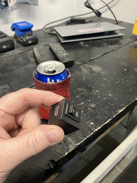

I have one of those relays with the toggle switch on it. Pop it in place of the starter relay under the hood and you can wheel the motor over with no key. I just use it to bring up oil pressure and change valve spring position every month or so during the winter when it’s parked instead of starting the motor and potentially not letting it warm up enough.

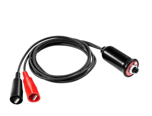

Ghetto
I use one of these when I work on my old cars. No idea if you can even easily get to the starter solenoid on something modern like a Hellcat though.
