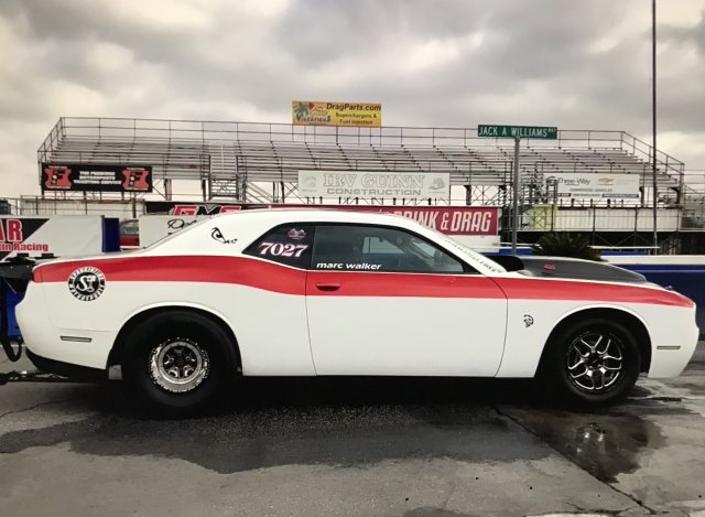

I put about 500 miles on the 18” Winlites with M/T Sportsman tires under normal around town and freeway miles. No issues. They drive, steer and stop nice. The Winlite is a superior wheel. 0D076FFF-2E7A-4E6C-8797-B6F6F0AB0228.jpeg

Mike,
The Weld Alumastar billet failures on the street is what brought me to ask about the WinLites. The hub design of the WinLite is much better for spreading load so I thought it should live better but thought it best to ask for real world experience.
Marc,
You are the type of responder I was hoping for. Good news or bad, it's always good to learn from other peoples' similar experiences. Thanks for letting me know you've had good luck with this setup.
