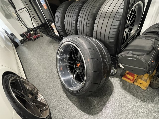

Not on 11”’s, but I am going to have them dismount my old 345/30’s and mount my two new 335/30’s on my Triumph 12” wide wheels. Probably sometime this week
I have 325/30’s on a set of 11” wides. I use them for the street.
Are you planning to use them front or back or both? Until I mount and try them, jury is out on using them up front. I do believe they have been tried, but can’t speak to the figment upfront. I am going to use them in the rear for HPDE running.

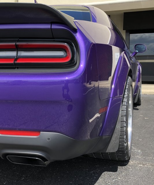

I have 335/30/20 on my non widebody challenger.
But I do have Phillips performance fender flares

Mine, on my NB (regular body) Challenger are 11.5 @TRIUMPH SVS.
Those flares really are some good units. Your car also is a great looking car.

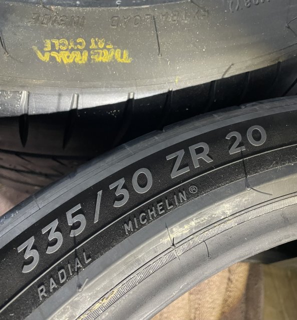

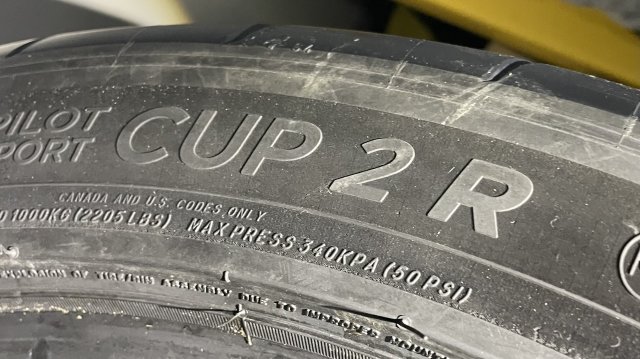

Got me a pair of something a bit special and a little smaller to try for the rears in a few weeks up at BIR…

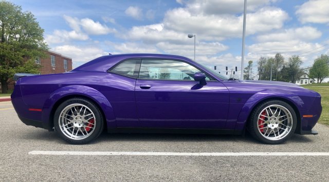

Cra97
#4683
69
199
Katy
2018 WB Hellcat
335/30/20 on 20x13R and 305/35/20 on 20x12F. I think 335 on stock wheel might be to big.

Sticky, they are keepers.😄 Did not see this until he updated the old thread. It gets new springs and will sit just a bit higher in front in a few weeks. I am going to check if they fit up front. That could be the ticket.
