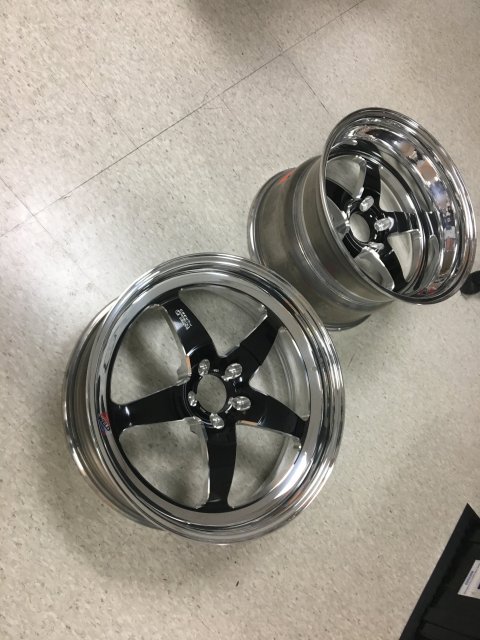

Thread Starter #14
The Welds should arrive today according to FedEx. w00t!
Now I just need to measure ID to order my hub-centric rings. I'll unbox them and post pics when they hit.

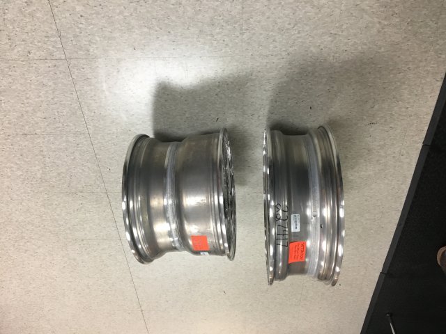

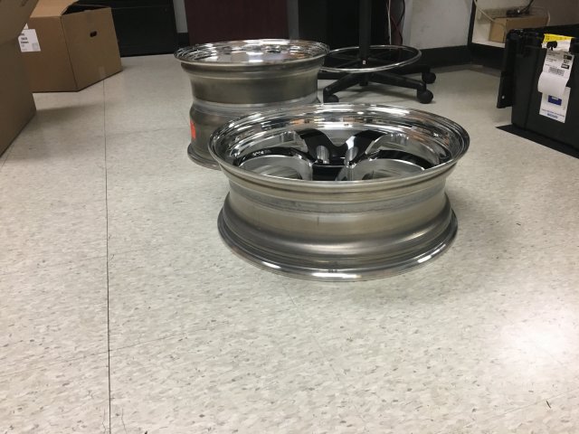

Thread Starter #18
37A2A214-6605-4BF5-A489-D3B7AAC38AD0.jpeg 1AE1B982-5E82-461F-B820-A84FEDCB005F.jpeg C1B31D02-7445-4980-8E77-EDF7BF204DCF.jpeg
11,829
20,038
son of bitch, that's pretty.
