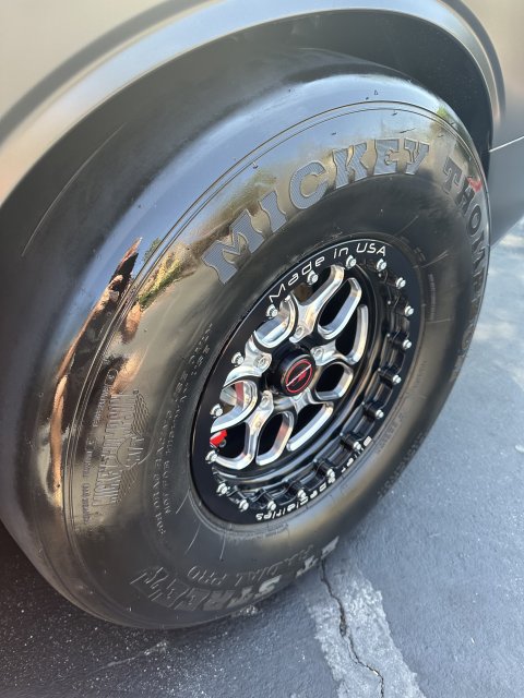

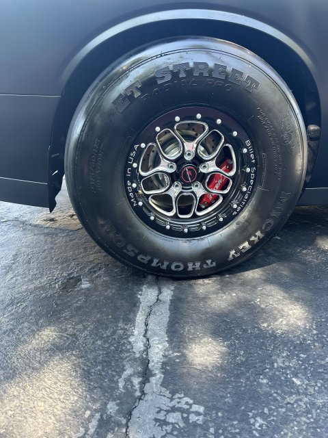

I have extended Dorman lugs and used some spacers and all is good. IMG_0184.jpeg IMG_0172.jpeg

im doing a spacerless one now unfortunately sorry they didn’t field your questions better
In all fairness it’s an entirely new wheel center to get the offset I designed.
