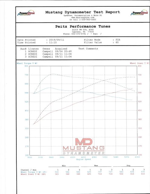

I picked up 98 rwhp by the mods. She's good to go on 93 octane. Mods are 2.85, catless mids, 180 stat, engine and transmission tune using HP Tuners.

Did you think to run the car with the Chiller system on? Would have been very interesting to see how much that system added to the stock baseline and how much it adds to the modded numbers.

Close to my mod list as well. I'll also be adding the ID1050 injectors. Do you know if only HPT software was used? Congrats on the new found power. I've been patiently waiting on some HPT software updates for the '19 RE ECU to take full advantage of these mods. Was hoping to see more than a 100 hp increase. With that said the power under the curve looks good. Should feel great. I'll see you at Baytown. I'm 3 miles from HRP.

I noticed the nice torque increase .

Nice gains, so this was done with a 2.85 pump gas 93 tune? I'm curious what is considered too much for a Redeye on pump gas as far as boost is concerned. I know the Hellcat guys usually stop around a 2.85 as well, but we are making more power than them on more boost stock. I'd like to see if I could pick up 100rwhp on stock pulley/stock boost on just an E85 tune.
