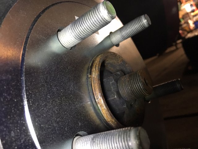

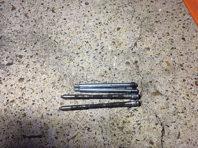

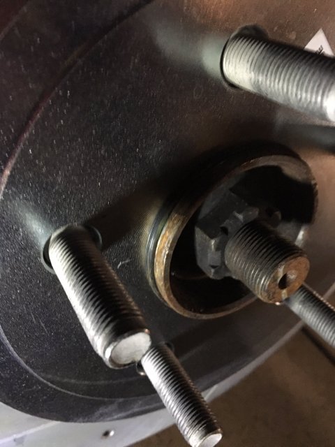

Lessons learned : reuse the pins in the back, ones supplied are too short. Do not reuse the original brackets from brembo, use the ones provided or they will rub (especially the back). There's an o ring/seal that rides in a groove on the backs. It was dark and I didn't see it well. Rotors won't come off without it (pics 87, 89, and 90). The small screwdriver will get them out.
