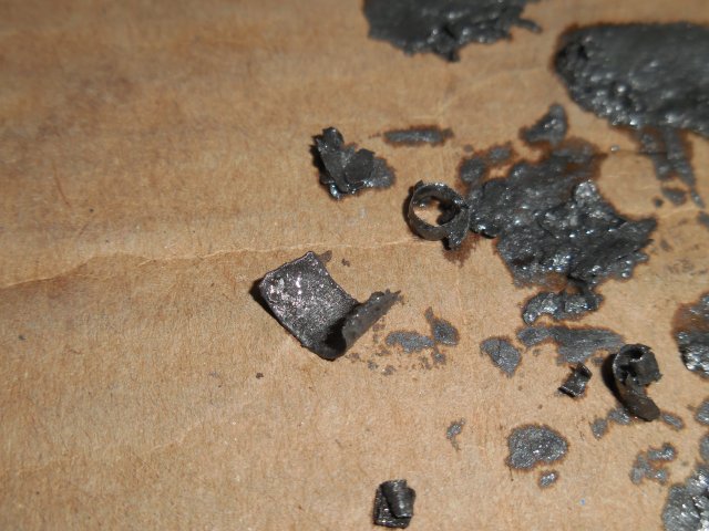

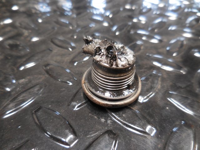

It's still FCA/Stellantis gears, which I haven't had good luck with. DSCN0843.JPG

Diff drain plug aye? Probably clutch material
No, level plug on a Ram. No clutches in that one, and friction material wouldn't be sticking to a magnet anyway.
Look at the nice curly pieces of metal. View attachment 87705
Semi metallic friction material is magnetic and that’s sure what that stuff looks like, Differencial clutch pack lining material.

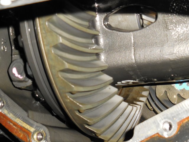

Trust me, that's not friction material from a diff with clutch packs.
For one, it looked and acted just like the mild steel chips you'd get when using your lathe.
But more importantly, the helical gear diffs in Ram pickups have no clutch packs. As you can (barely) see at the top of the photo. It's all gears. DSCN0844.JPG
But more importantly, the helical gear diffs in Ram pickups have no clutch packs. As you can (barely) see at the top of the photo. It's all gears. View attachment 87717
Yea, agree, that does not look like a normal diff with clutch packs. My boy ruined the Diff in his RX8 doing a zillion doughnuts and what was stuck to the magnet was clutch pack shavings with that same metallic marbling in it.
