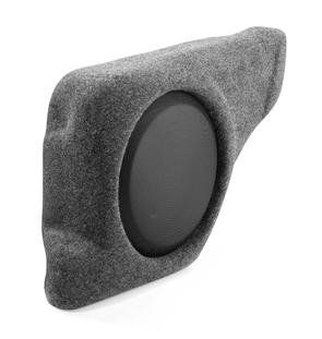

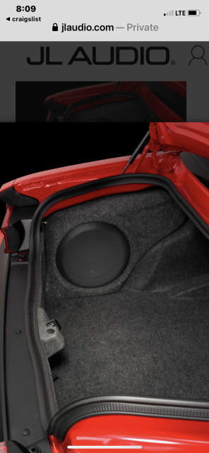

Just like the title reads, anyone have any experience with this subwoofer? I bought the Performance Spare Tire kit, but still have the factory subs in the tire well and keep trying to find some subs custom fit to the car, so I can mount the spare where it belongs. Any opinions? 7DF586D4-D243-480B-9B02-89389B094B73.jpeg 0B7FC7DB-97B3-40A6-9B4E-EBF11F0658F7.png

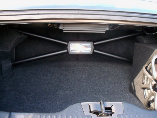

I found a box made to fit my last Mustang and put in a 10" Kicker. So there may be more options

I understand what you mean, regarding the sound of the two 10” HK subs (which I have in the car now) vs the single 12” JL Audio sub, which also requires a separate amp. However, my objective is to get a spare tire in the well now occupied by the HK subs. If I lose a little bass doing that, I can live with it. I bought a spare tire kit, but hate having it bouncing around, loose in the trunk and taking up a bunch of room. Besides, I have horrible hearing already, I’ll probably never know the difference!

I'm going to try one. Is the 'box' plastic or fiberglass?

They’re fiberglass, I believe. I bought one locally for sale on Craigslist. Looks good, well made. Fairly heavy for its size. I haven’t had it installed (along with a new 500 watt JL amp) yet. Next week.

I bought some 3/4 MDF and was going to try to make something up like you’re referring to, but didn’t want to end up with a bunch of time into it and not have it look 100%. The Stealthbox absolutely looks like it’s OEM when I placed it in position, for what that’s worth. I tried to find someone that made custom boxes to fit, but was unsuccessful. There’s another thread on here that had to do with spare tire setups which had information from another forum member who had custom boxes made for both sides of the trunk. I actually contacted the person that owned the audio shop that made them, but could never get them to even give me a price. Finding the Steathbox on Craigslist for $150 seemed like I couldn’t pass it up. Combined with the Perfomancespare, I can have a trunk, spare tire where it belongs and hopefully, good (enough for an old half deaf guy like me) sound.
